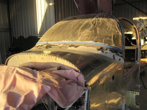

Brief Description:  Windscreen & Doors
Final contouring of the fairing around the windscreen and doors. There was an issue where the fiberglass strips on the windscreen were a little proud of the doors. It took awhile but the door edges are perfectly flush with the cabin cover edges.
The next task is to open up the gap to accomodate the paint thickness.
