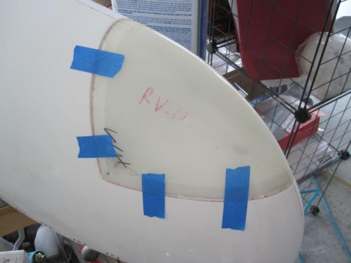

Brief Description:  Wing Tip Lense
24-2, Steps 5, 6, & 7
Drill #40 the VA-193-L Left Lens into the W-1015-L Wing Tip at the upper and lower corners using the dimensions given. After drilling cleco each hole. Remove the tape and check the fit. Final-Drill #28 both holes in the wing tip and the left lens.
Match-Drill #40 the nutplate attach pattern into the W-1015-L Wing Tip, orient the nutplate approximately as shown. Countersink the VA-193-L Left Lens for the head of a #6 flush head screw and the W-1015-L Wing Tip for the AN426AD3 nutplate attach rivets.
Install the VA-193-L Left Lens using the hardware called out.

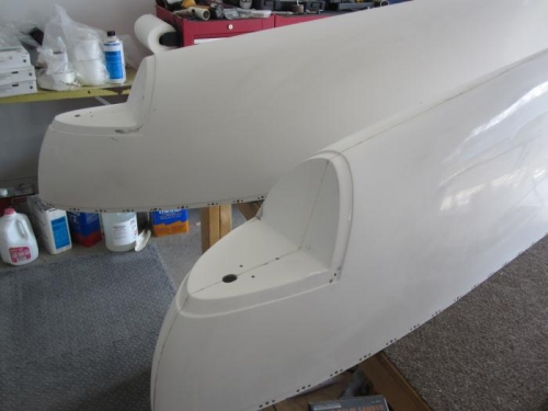

I purchased Cee Bailey's Lenses. The left one fit just fine, but the right one was 1/8" too short. I'll need to get a replacement lense to complete the other wingtip.
