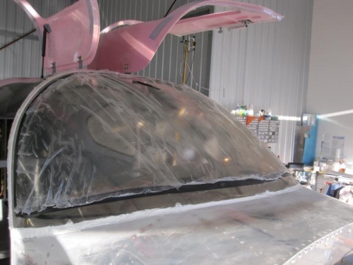

Brief Description:  Tape the windows, prep for fiberglassing the joint
45-18, Step 5
Define the extent of the fairing on the windscreen by placing two layers of good quality electrical tape on the windscreen. Mask-off the entire windscreen EXCEPT for the perimeter areas that will be covered by the windcreen base fairing or paint.

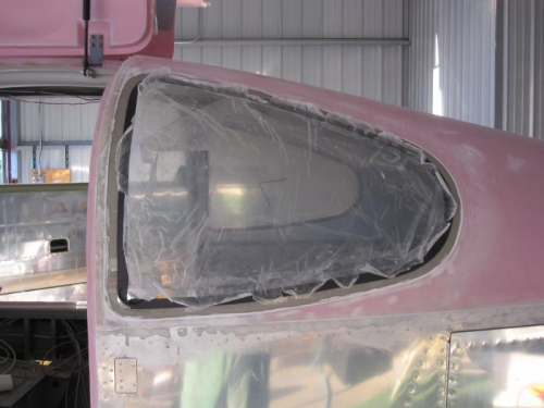

I did the windscreen and the two rear windows.
