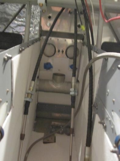

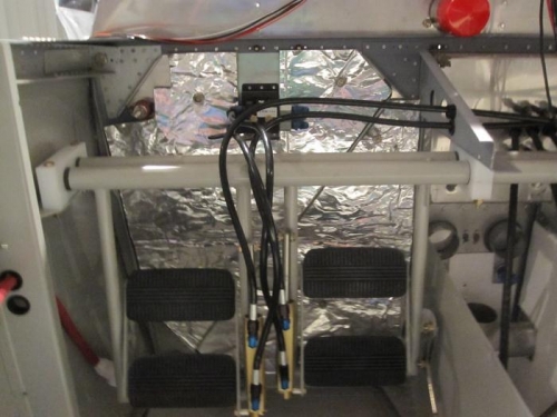

Brad and I worked on installing more insulation on the firewall. Brad put a small piece of Fiberfax on the firewall in front of the tunnel. I'll put more insulation on top of this later. We used a ceramic blanket in between a layer of stainless steel foil and aluminum foil. We started to run the brake lines, but I didn't have any adel clamps of the correct size. ACS is loving me this week. Two orders in one week. I'm at the point, were timing is more important that the shipping fees.
Ceramic blanket on the firewall
Fiberfax cermanic blanket in the tunnel
