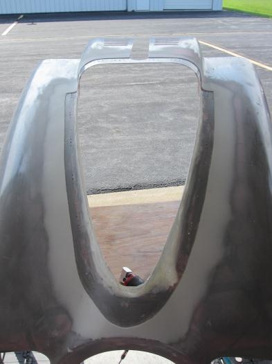

I spent time sanding the micro fillet on the cowl mod. Using the supplied templed, I drilled th rivet holes to mount the MilSpect fastners.

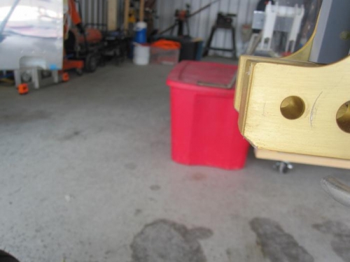

I also beveled the lower corners of the F-1004A and F-1004B Center-Section Bulkheads as well as the F-1004F and F-1004H Center-Section Lower Forward/Aft Bars to eliminate interference with the T-1001-L Fuel Tank Skin during assembly.
Cowl Mod micro fillet
Beveled spar
Beveled spar
