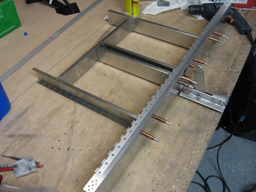

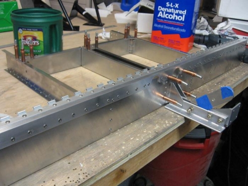

Brief Description:  Under Seat Structure Final Assembly
Riveted and installed the under seat structure. Riveted most of it on the bench, then installed in the airplane. This was a really good idea I saw on others' builds; I don't think I could have gotten to a lot of the rivets from inside. The ones I did have to do inside were very tight, and I had to do a few over because they didn't sit right due to access issues.
In the end I got it all done, but I'm glad it's over. Next I'm on to the seat sling.
Riveting on the Table
Rivet Detail
Rivet Detail
