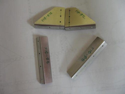

I'm waiting on some drill bits to continue updrilling the fuselage parts on page F10, so I went to page F09 and started making parts. I got the -07 clips, -08 clips, -10 channels, and -13 channels made.

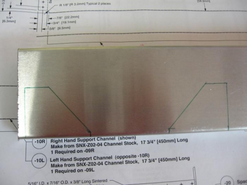

The plans call for the clips to be made from 0.032" sheet, but I didn't have any of that and had lots of 0.032" channel so I made them from channel. Because of the channel bends, that meant I didn't have to bend or radius the parts, which saved some time. I did have to remake the -07 clips though, as the first set I made looked thin, so I took the calipers to them and realized I had used 0.025" channel, so I got to re-make them in 0.032". Measure, THEN cut...
channel with -07 clips drawn
finished -07 and -08 clips

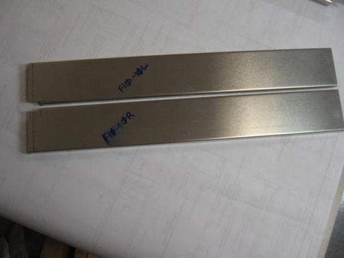

Finished -10 channels
