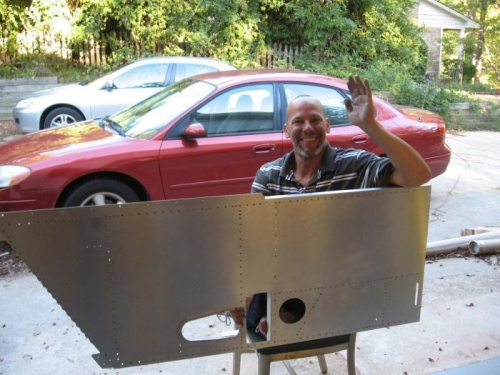

Brief Description:  Forward Fuselage Side Panel Riveting
It seems like I've been working on the forward fuselage sides forever, but I finally got to rivet them up! There were some areas where different rivet lengths were called out, so it pays to pay attention to the plans. I had to drill out a bunch of rivets where I used shorter ones thinking they were like the surrounding rivets (wrong!), but once I saw where my mistake was I didn't repeat it.
The plans also require leaving the aft spar tunnel attach angle un-riveted, as without doing that getting the spar tunnel riveted in is almost impossible. These rivets will be added at a later build step.
Trying On Riveted Side Panel
