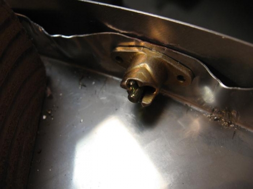

Date:  9-3-2011
Number of Hours:  3.00
Manual Reference:  SNX-F17
Brief Description:  Upper Firewall
Installed the Camloc recepticles on the upper firewall. For some reason I had a lot of trouble drilling small 5/64" pilot holes for the 3/32" SSC-34 rivets, and I wrecked a lot of 5/64 drill bits in the process, even using proper technique of slow drill speed and lots of oil for lubrication. In the end I got it all done, the holes dimpled, and everything ready to rivet.
Camloc Fastener
Camloc Fastener
