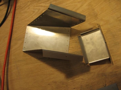

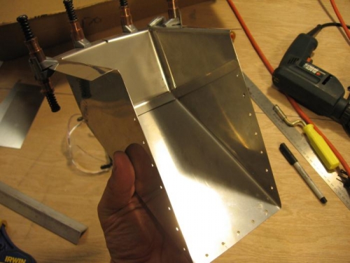

Formed the stainless steel filler box parts. It takes more force than forming aluminum, but was not overly difficult since the parts were pre-shaped at the factory and just required bending to the required angles. I clamped together the box and box end to test the fit; it seems to fit very well.

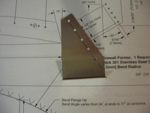

I also re-made the F17-10 clip, as the first version I made had an incorrect angle to it. The new one is pretty darn close to plan spec.
