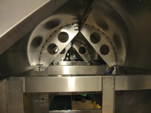

Manual Reference:  SNX-F19
Brief Description:  Turtledeck Formers #4 & #3
I installed the #4 and #3 formers and pilot drilled them. I was careful to make the fit to the turtledeck skin as tight as possible, to minimize the need for shims between the skin and former (needed where gaps exist to prevent skin dimpling on riveting).
