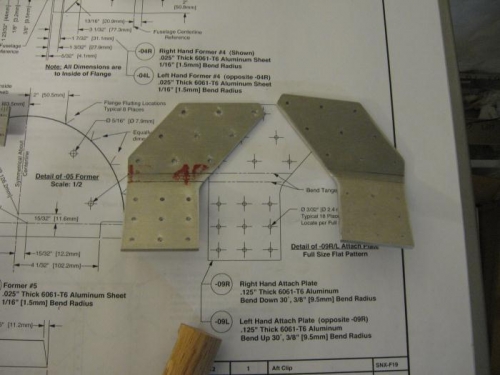

I also went ahead and put the 30 degree bends in the 1/8" forward former attach brackets using the arbor press. This went quickly and without incident, so I'm getting better and doing those kinds of bends at least.
#1 Former Brackets Bent 30*

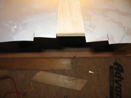

Notches Cut in Rear of Turtledeck Skins
