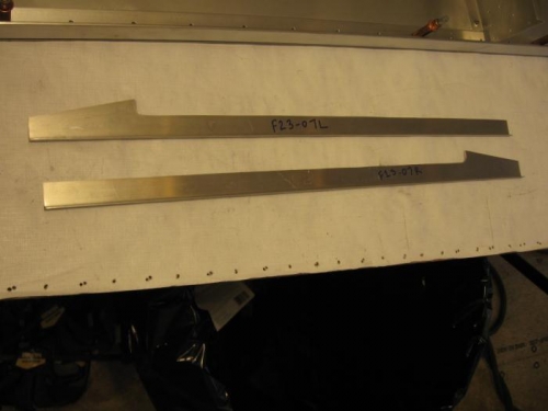

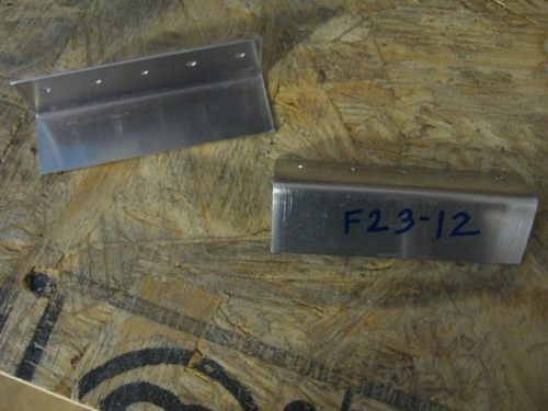

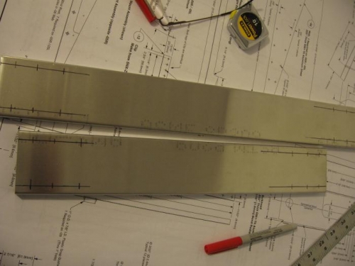

Page SNX-F23 is a bunch of misc parts for the aft fuselage. I made the -12 through -7 pieces (two clips, two channel supports, two web support angles). The only tricky parts were the -07 angles, which required a lot of shaping and a fat 1/2" drill bit to get the 1/4" radius specified. I think they came out great.
