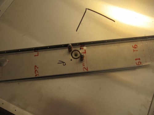

I attached the phenolic blocks with fairlead guides to the forward and aft vertical channels (didn't do remaining guides yet, because the Wick's hardware kit did not include them...will have to order).

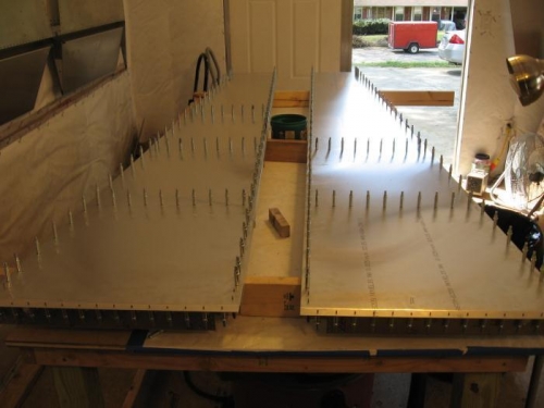

Also updrilled longerons, channels, and skins. I screwed up by not reading the plans closely enough, and updrilled the upper longeron/skins, which I was not supposed to do until the turtle deck skins are fitted. It remains to be seen how much of a problem this will be, though I should be able to updrill to 5/32" holes and use CCP-54 rivets instead of CCP-44s in the worst case. So, not a disaster.
Phenolic Block Attach Example
One Side Updrilled
One Side Updrilled
