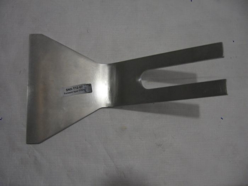

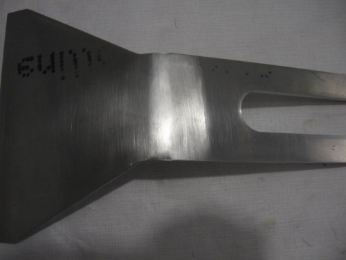

I finished & bent the forward spar fitting (SNX-T12-07) to the 35 degree angle specified. The part got a LOT of "orange peel" on the outside of the bend from bending stresses. I removed this with the scotch-brite wheel and pads.
It seemed like I removed a lot of material, and I don't want to weaken the part too much, so I'm going to take it to the EAA meeting Saturday and let them say if it looks compromised. I don't think so, but it's always good to have a few more eyeball on these things.

fwd spar fitting side 1
fwd spar fitting side 2
