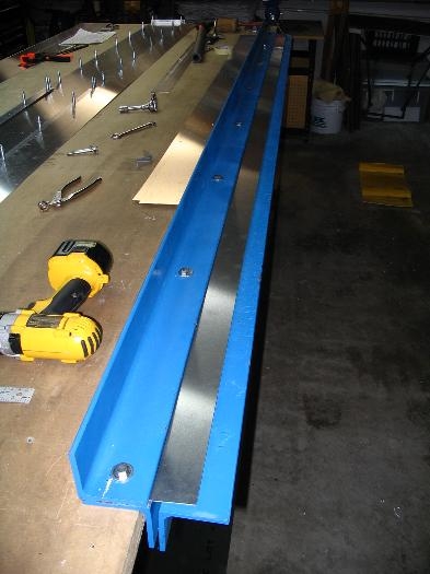

Brief Description:  Full-length bending brake
If the final web flange dimension you are bending is less than the distance from the radius edge to the closest edge of the bolts, you can insert your web under the bolt holes, drill tham out and bolt at every location, increasing the grip and accuracy of your bend.
Web drilled at each location
Web removed to show the holes...no problem
Checking the 102 degree angle with a bent strip.  Very convenient.
