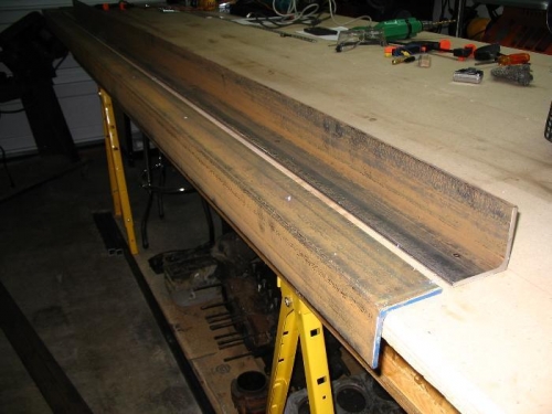

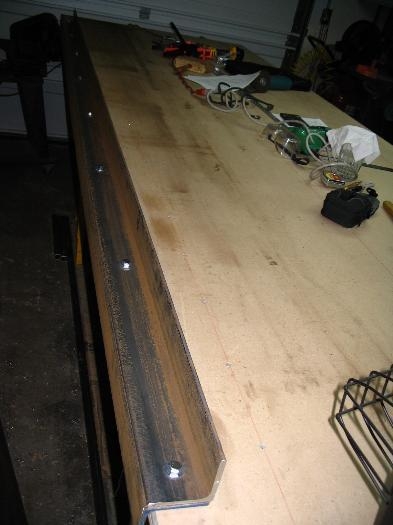

Brief Description:  Bottom and Top Plates of Bending Brake in place
After cleaning off the rust, I drilled seven #20 holes for countersunk wood screws to secure the bottom plate to the edge of my work table. Next I ground a 1/8" radius on the leading edge of the top plate, positioned the plate and drilled eight holes for the 3/8" bolts. (Time: 5.0 hours)
The bottom plate secured by countersunk wood screws
The top plate bolted in place
