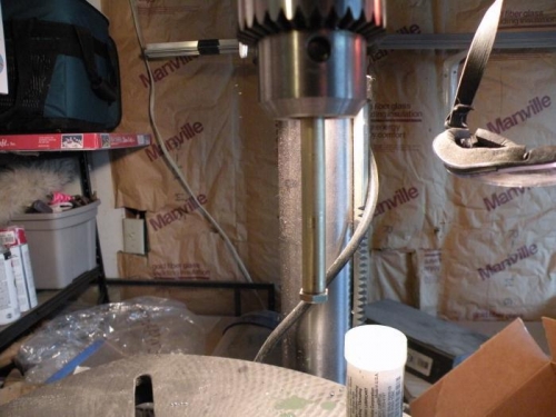

Tonight I futzed around some more trying to get the right aileron bellcrank to work better. Removing the bushing from the bellcrank, I noticed a series of shiny bands on the bushing where I assume the bellcrank is dragging on the bushing. I rigged up 5 washers and a jam nut so I could chuck the bushing in my drill press without the chuck marking it up. This helped a little, but I never could get the bushing chucked up squarely again after that first time.

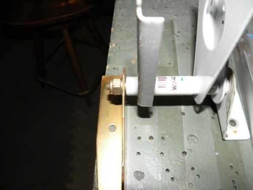

The bushing IS sufficiently longer than the bellcrank. It's NOT dragging on the ends.

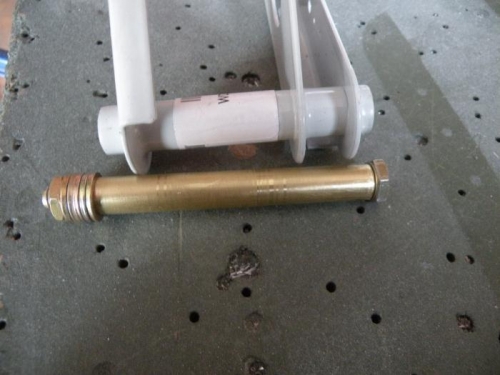

Shiny bands where the bellcrank is dragging on the bushing.
Chucked up for polishing.
