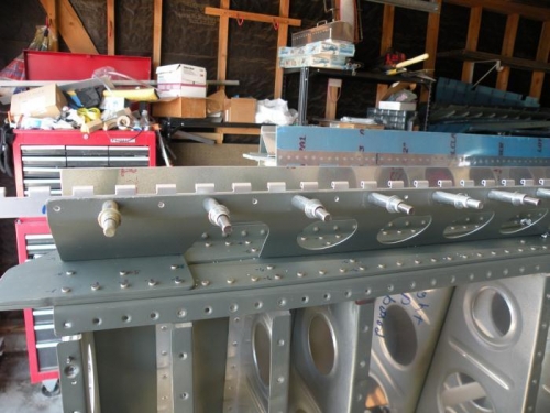

I then countersunk the flap brace to accept the dimples in the wing skins. The depth of the countersinks causes a pilot to be required, so I clecoed the hinge back to the brace and used its holes at pilots (photo 1). Worked great.

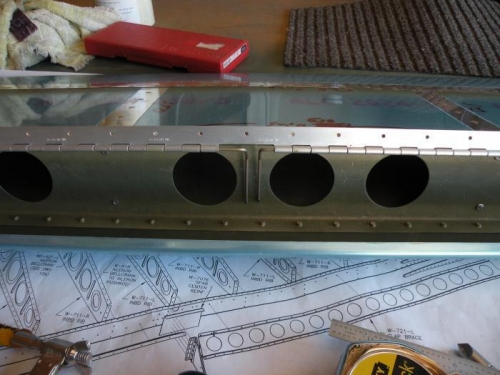

I finished up the day by cutting and bending the hinge pins for the left flap (photo 2).
Using the hinge holes as pilots for countersinking the flap brace.
Hinge pins for the left flap cut and bent.
