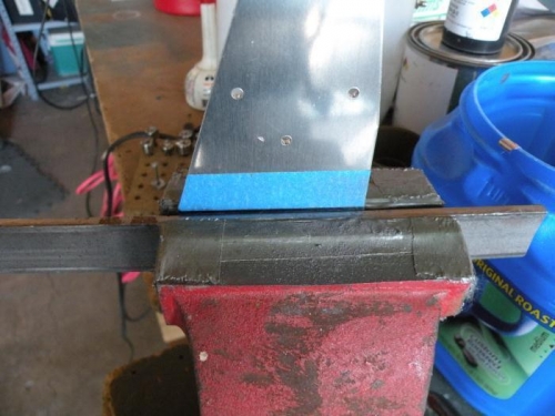

I then bent both FL-706B's according to the plans. Not yet having the FL-706A's fabricated or attached to the spar to check the bend angles, I applied some trigonometry to calculate the dispacement at the aft end of the plate.

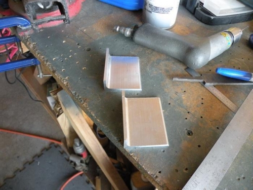

I then fabricated both FL-706A's from the supplied angle. I cut both the overall length and the width of the narrow leg by scribing the final dimensions on the part, then used the bandsaw to cut about 1/16" outside the scribed lines, then used the belt sander to grind the part to the final dimensions.
(continued in next entry)

Setup for bending the FL-706B plates.
Both FL-706A's cut and ground to final shape.
