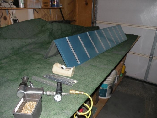

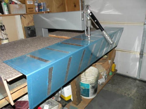

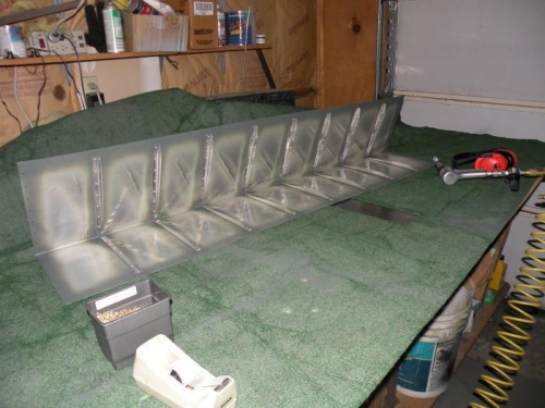

Today I de-vinyled the stiffener rivet lines on the replacement left aileron skin, dimpled the skin and stiffeners, and backriveted the stiffeners to the skin. I had completed dimpling the upper side of the skin and had just started on the bottom when it occurred to me that I hadn't deburred the exterior of the holes. They weren't bad enough to worry about, but I did give them a turn of the deburring tool before continuing with the dimpling.
No rivet count update today, since these have already been counted on the first iteration of the left aileron.
Dimpling stiffener rivet lines in the skin.
Rivets inserted and taped to the skin.
All stiffeners riveted to the skin.
