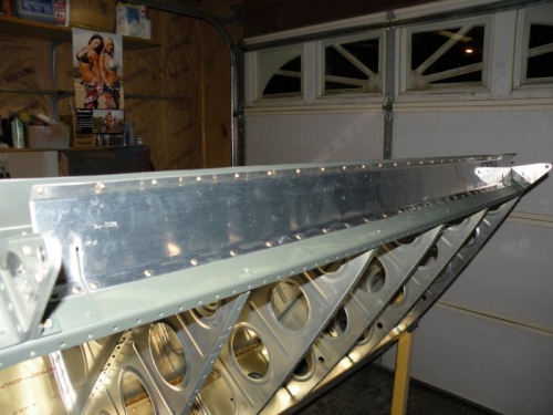

Brief Description:  Right Aileron Gap Fairing
Tonight I riveted the aileron gap fairing to the right wing. Between breaking the edges of the fairing flanges, and shooting and bucking the skin rivets, I got MUCH less pillowing between rivets than on the left fairing.
Rivets Today: 55
Rivets Total: 6418
Much less pillowing between rivets than on the left one.
