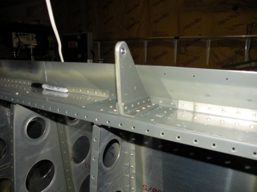

Brief Description:  Right Wing - Aileron Hinge Brackets, etc.
I finished assembling the right inboard aileron hinge bracket, and installed both brackets on the wing. Per the plans, the aileron side of each bracket attach angle gets a flush rivet in the lower hole for clearance from the aileron.
After finishing the aileron hinge bracket assemblies, I drilled the aileron gap fairing to the rear spar and top skin. I then trimmed the flap brace to fit around the rear spar reinforcement fork, and drilled the brace to the spar. I deburred the rivet holes in the brace and seal, but haven't yet deburred the spar or skin.

Right inboard aileron hinge bracket assembly riveted to the rear spar.
