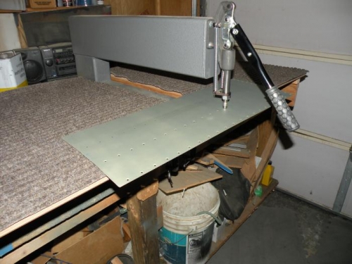

Tonight I set up the dimpling table, and Karen helped me dimple the right leading edge skin. I then dimpled the right wing walk doubler. I used tank dies on the wing walk so the standard die dimples in the skin will nest better. I'll use substructure dies on the ribs under the doubler.
Dimpling the right wing walk doubler.
