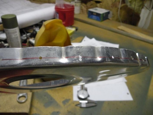

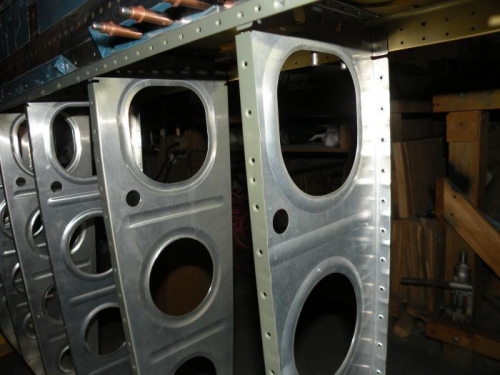

First, I dimpled the wing ribs. I used tank dies everywhere except the top sides of the first four inboard ribs, and both sides of the #8 rib (counting from inboard) where the main skins overlap. I used substucture dies in these areas because the doubler and skins that directly interface to these areas are dimpled with tank dies. I paid for the bad habit of holding the squeezer trigger out of its safety detent between dimples by inadvertently punching a new dimple in the bottom side of rib #9 (see photo 1). It's in the bottom of a flute so I'm not going to try to flatten it, but since edge distances aren't violated I'm thinking I can just deburr it on the back side and move on. I'll check with Van's to be sure.

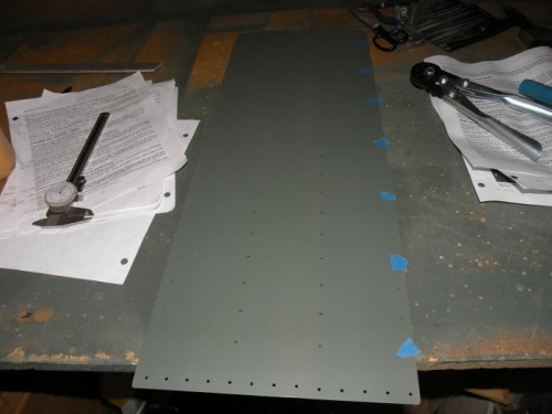

Lastly, I removed the W-408 inboard leading edge rib and joint plate I drilled yesterday, and deburred the skin and joint plate. I drilled the first hole before ABSOLUTELY making sure the rib was located correctly, with the results shown in photo 3. I'll ask Vans if I can deburr and ignore, but I'm not as sure of an affirmitave response as I am with the extra hole in the rib. The skin and joint plate are fine.
