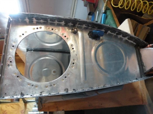

Today I attended a memorial service for a fellow aviator (Good Trip West, Ozzie!), so I didn't get started on the RV until mid afternoon.
I wet-riveted the inboard end rib, encapsulated the shop heads, and cleaned up the outside skin. I also permanently installed the vent line fitting. Since the fitting has no provision for safetying (and probably doesn't need it in most situations), I encapsulated the fitting in sealant. I couldn't get a full wrap of the fuel sender wire around the inboard section of vent line, so I'll lace it up in a couple of places and secure with dabs of sealant before closing the tank.
I still have to install six #4 rivets to secure the reinforcement plate and tank attach bracket, and locate the pickup tube on the cover plate before installing the tank baffle. Almost there...

Left tank inboard end rib riveted and shop heads encapsulated.
Vent line fitting installed, torqued, and encapsulated.
