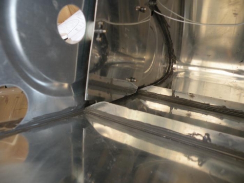

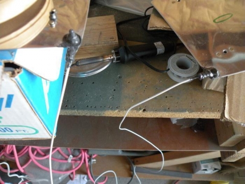

For both tanks: Sealed wire terminations to outboard capacitance plates. Installed and sealed BNC connectors to inboard ribs. Sealed and riveted the T-407 reinforcement rings with nutplates to the inboard ribs.
For the left tank only, I trimmed the outboard capacitance plate to clear the stiffeners, and final installed it to its interior tank rib.

Terminations on outboard plated encapsulated in sealant.
BNC connectors installed and encapsulated.
