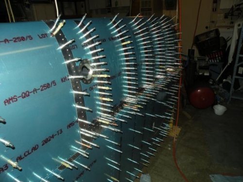

Today I got all five interior ribs sealed and clecoed. As mentioned before, I'm using Rick Galati's McDonnell Douglas method of assembling the tank: apply sealant, 100% cleco, then wait a day before riveting. All went fairly well. I mixed one 26-27 gram batch of sealant for each rib, and applied it to both the skin and the rib with an acid brush trimmed to about 1/4 - 3/8 inch long to stiffen it up. This made the application MUCH neater than some jobs I've seen, and also came in handy for forming the fillets.
I did notice that the skin wanted to pull away slightly from the aft end of the rib flanges, so I dry installed the baffle to pull it in to its final position while the sealant cures. You might notice in Photo 3 below that I only attached the baffle with three clecoes at each rib (top and bottom) and two at each corner, due to the fact that I was running a bit short on 3/32 clecoes. I also clecoed the tank to the wing spar to ensure it didn't get tweaked during assembly. Looks great!

All five interior ribs sealed and 100% clecoed.
I clecoed the tank to the wing spar to ensure that the tank was not tweaked during assembly.
