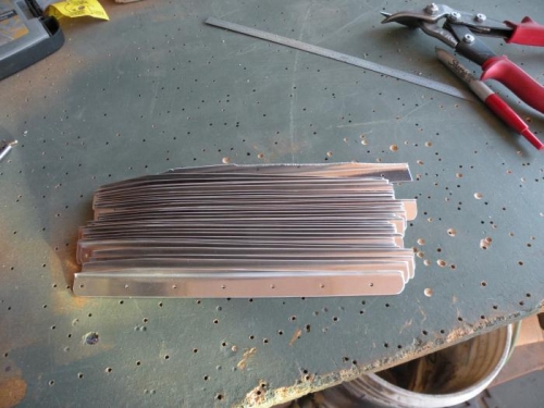

I received my substructure dies from Cleaveland Tools, but first I finished up with deburring the edges of the aileron stiffeners I started in the last work session(1.1 hrs). There is one that I cut inside the line on the long angle (see photo), so I will have to replace. I'll put one stick of A710 stiffeners on a list for future orders.
The substructure dies work great. I test fit a couple of tank stiffeners after dimpling, and they fit nice and flush without any slop. I dimpled the stiffeners for both tanks, and the ribs for the left tank (right tank ribs haven't yet been drilled). (0.7 hrs)
