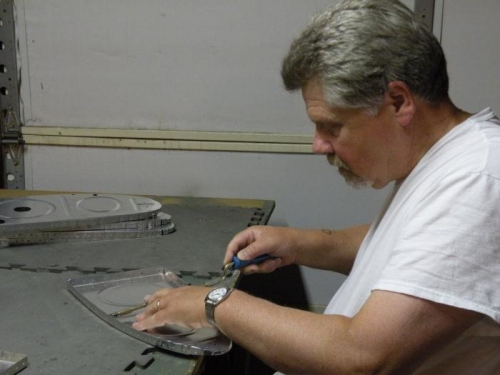

Deburred rivet holes in ribs. I noticed that some of the rib to baffle holes were smoother than expected. Testing the holes with the prescribed AD-42H rivet, showed several to be still undersized, indicating they haven't been drilled. At the next work session, I'll cleco the ribs to the baffle and drill the holes to final size before deburring the baffle.
Deburring left tank rib rivet holes.
