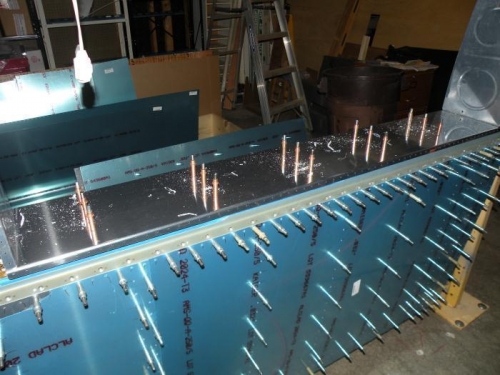

According to the photo timestamps, I spent about 1 hour 10 minutes of work to install the ribs into the left tank skin. The thicker tank skin is quite a bit harder to conform to the rib profile than is the leading edge. I started with the skin out of the cradle, and clecoed the top side, with the most forward cleco going in first from the inside, as in the leading edge. Easy peasy. Not so for the bottom side... After much wailing and gnashing of teeth, even with the tank skin in the cradle I could NOT get the most forward holes to line up. I finally figured out that I could get the aft most cleco in. As I worked my way forward, the rib gradually nested into the leading edge. That forward-most cleco that had been so stubborn earlier practically fell into place.

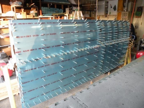

From wing skeleton on the bench with rear spar clecoed on to this in 3 days. All weekends should be this productive!

About 1:10 to install the ribs in the skin.
Looks like a wing!
Looks like a wing!
