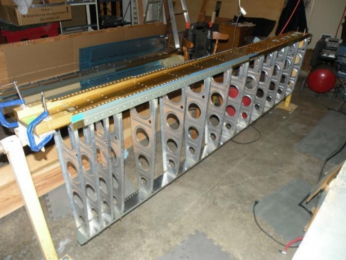

Clecoed the rear spar to the left wing skeleton.

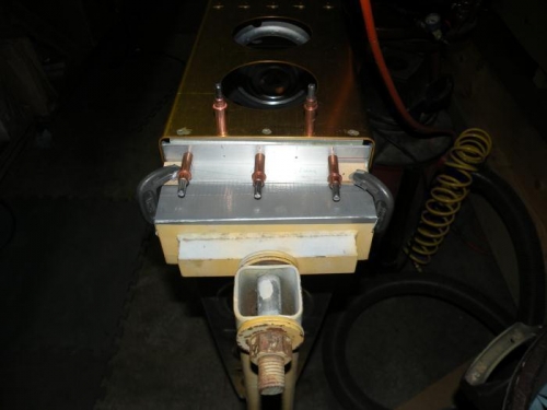

Moved one wing stand out by 3-1/2" to account for the longer RV-7 wing. I got that stand a little twisted, as evidenced in the photo of the outboard end. I leveled the spar crosswise at both ends, but I think I'm going to switch ends, so the angle on the outboard rib will be better supported. I'm also going to replace the clecos holding the angle to the outboard rib with 3/16 bolts.
Left Wing in the stands and leveled crosswise.

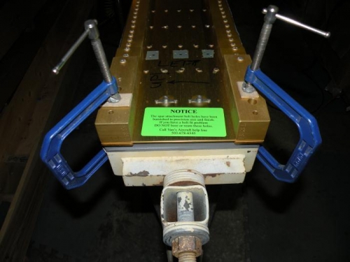

Inboard end secured and protected.
Outboard end secured and protected.
