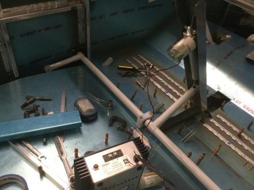

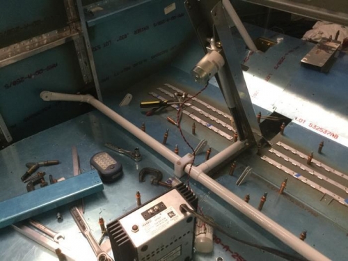

Riveted the F-766B angle bracket to the F-766A channel and temporarily installed the F-766 channel assembly in the airplane, connected the flap motor, and ran several up/down cycles of the actuator. I'm still about 3 days away from receiving the replacement F-785A channel, so I can't yet complete the electric flap system installation.
Rivets Today: 3
Rivets Total: 12034
Jackscrew retracted = flaps extended.
Jackscrew extended = flaps retracted.
