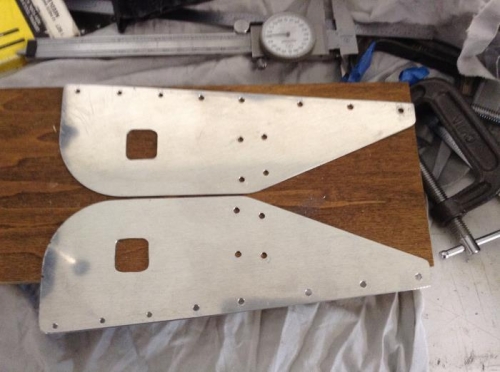

I started by cleaning up the canopy latch holes in the F-757 gussets (photo 1). They aren't perfect but I guess they'll do.

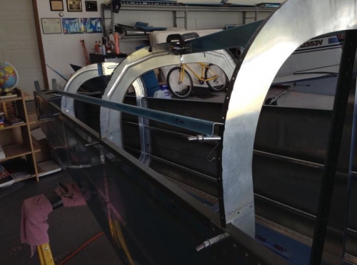

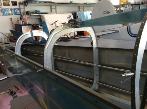

The next item is to bend the F-706, 707, and 708 bulkhead flanges so they will lie smoothly against the skin. The manual says to use a straightedge or taut thread for reference. Not having a 50+ inch straightedge, I went with the string (photo 2), but it was hard to tell the angles at the ends of the string on the 706 and 708 bulkheads. Then it dawned on me that I had already cut the J-stringers to length and that they are fairly straight. Bingo! (Photo 3), I got the right side flanges on all three bulkheads pretty much in shape before it was time to quit for the day.
