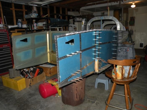

Today I reinstalled the forward half of the F-704 bulkhead. I was going to be within an hour of Corona anyway, so I stopped by Aircraft Spruce and picked up my order of AN4-33A spacer bolts, along with some other odds and ends. The installation and torqueing of these bolts with the spacers was straight forward.
With the F-704 bulkhead back in, I clecod the forward side skins on for what I hope is the last time, then started to add the structure back into forward fuselage.
