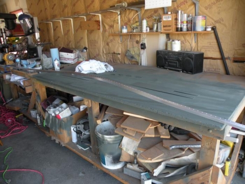

Today I scuffed, cleaned, and primed the outside faces of the forward half of each main longeron. I also finished priming the various ribs, doublers, clips, and spacers used in the center and forward fuselage.
I then deburred the inside of the double row of holes in the aft fuselage skins where they connect to the aft end of the forward fuselage. I still need to devinyl the exterior of the forward end of the aft fuselage skins where the side and bottom skins of the center fuselage overlap before deburring and priming them.
I also deburred the rivet holes in the lower half of the flanges of the F-706 bulkhead.
Ready to prime the outside faces of the forward half of the left main longeron.
