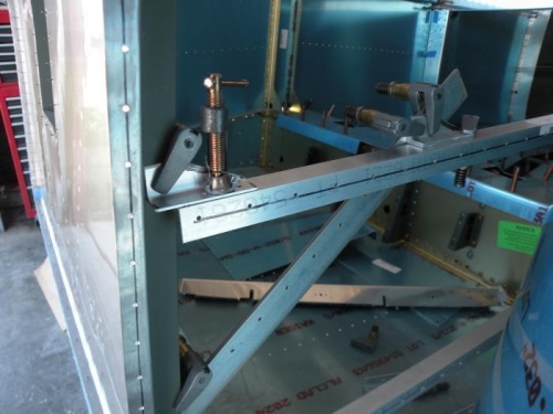

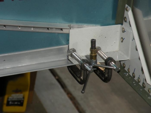

I started by fabricating the right side angle clip that attaches the forward skin stiffener to the firewall vertical stiffener. This being the fourth one I've made, it only took about 20 minutes. I then pre-drilled the three holes in each clip called out on dwg 23. I lamped the left clip in place and adjusted the height of the left stiffener for drilling. I then braced the left skin stiffener to maintain its proper position and peeled the skin back (photo 1) for drilling the clip to both stiffeners. See results in photo 2. Note that I notched the forward inboard corner of the stiffener to clear the vertical firewall stiffener.

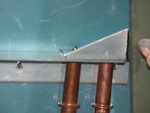

I then laid out and pre-drilled to #40 the four vertical bolt hole locations in the forward end of both lower longerons. I then removed the bottom skin and test fit both lower longerons. With the forward ends clamped firmly to the lower engine mount brackets (photo 3), the lower longeron does indeed extend 1/8" below the bottom of the F-770 side skin along its entire length, as it should. I drilled the vertical bolt holes in the left lower longeron to the left lower engine mount, progressing through #40, #30, 11/64” drills, followed by a 3/16" reamer.
The forward skin stiffener braced so the skin can be peeled back.
The angle clip drilled to the skin and firewall stiffeners.
Lower longeron clamped in place ready to drill the vertical bolt holes.
