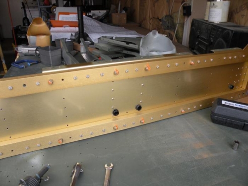

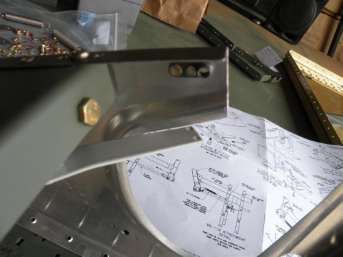

The fact that the aileron trim arm came out about 3/8 inch further to the left than it should have has been bugging me, so I reassembled the system to the left inboard seat rib, hooked the servo up to my car battery and ran it fully both ways to check for adequate clearance and no binding. It works just fine, but in the full left position, there's only about 1/32 inch clearance with the rib lightening hole (photo 1). To provide a bit more clearance, I marked the edge of the hole where the arm came the closest, and relieved it about another 1/8 inch (photo 2). I feel better now...

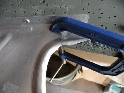

With that little job complete, I riveted and bolted the two most inboard seat ribs to the aft half of the F-704 bulkhead. If you look close at photo 3 you'll notice I put the rivets' factory heads on the bulkhead side of the joint. Normally, shop heads would go on the thicker metal, to reduce the chances of distortion on the thinner metal, but I'm not comfortable enough with the offset universal rivet set in the gun, which would be required in order to get the gun between the ribs. I have NO distortion of the rib flanges from bucking the shop heads.

There IS some clearance in full-left position, but it's only about 1/32 inch.
Clearance for the aileron trim arm at the full left position.
The two inboard seat ribs riveted to aft F-704 bulkhead.
