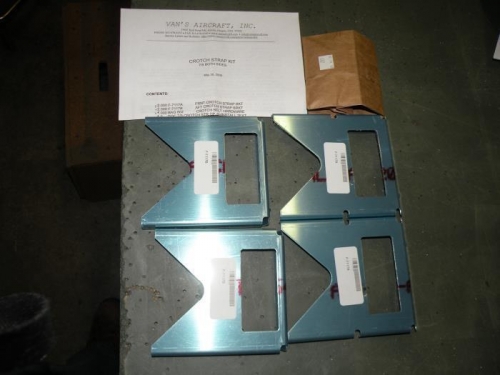

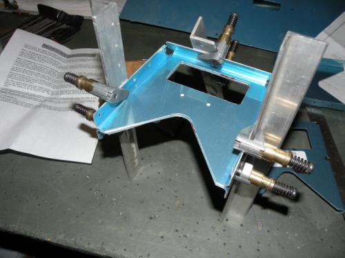

Just for a bit of a (badly needed) change of pace I broke out the crotch strap installation kit, and reinstalled the seat ribs to the F-404 bulkhead in preparation for drilling the crotch brackets to them. The pre-punched holes for the strap fitting bolts are for Vans belts, but I'm about 90% sure I'm going with Crow harnesses, so I'm going to call them and get some dimensions on their strap ends before I drill the brackets.
Vans crotch strap kit.
The front and rear brackets aligned and clamped for drilling the hole for the strap bracket bolt.
