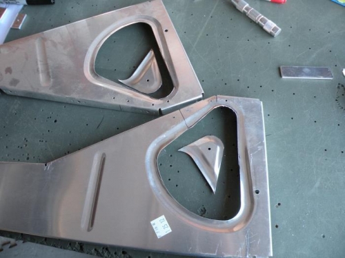

After finishing up riveting the aft fuselage I got started on the center fuselage. I started by fabricating the F-916C spacers. The seat ribs have two flanges on the aft end, one offset from the other by 1/4 inch to account for the rear spar carry through being two 1/8 inch thicknesses toward the outboard ends. The inboard seat ribs fit over only one thickness of the rear spar carrythrough, and the F-916C spacers make up the difference.
I then modified two of the inboard seat ribs to accommodate the control column access plates. When enlarging the lightening hole, I missed the note that has you cut a 1-1/2 inch hole centered on the 1/8" hole (in the removed part in photo 1), but I hit it fairly close by free handing a line and using snips to remove the section. In a slight deviation from the plans, I'm using one-legged plate nuts in lieu of loose nuts and washers for the screws that attach the access plates. I still have to enlarge the lightening holes on two more inboard seat ribs, and I seem to remember some builders adding access plates to these ribs as well. I'll do a bit of research on the VAF forums before I commit.

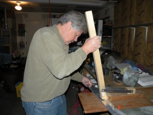

The instructions don't mention it, but the seat rib flanges need to be squared to the web. To accomplish this I used the same tool I made for the wing ribs (photo 2). I then fluted all of the F-716 ribs to straighten the flanges and hopefully ease clecoing them to the center bottom skin. I will also flute the F-715 seat ribs to make them fit the side contour of the airplane, but I'll have to mark the hole positions through the skin first.
Modifying two of the inboard seat ribs.
Squaring the flanges of the seat ribs.
