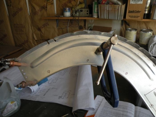

When I was final drilling the F-708 parts originally I'd neglected to drill the static tubing attach clamp holes. I laid these holes out on one half of the bulkhead, and then clamped the other half back to back for drilling.

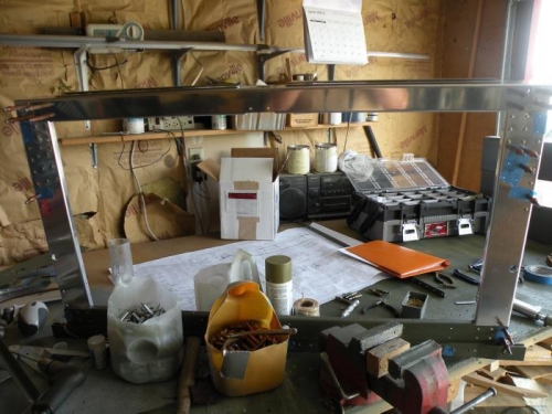

All rivets currently called for in the F-706 bulkhead are set.

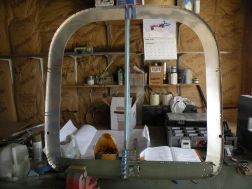

All rivets currently called for in the F-706 bulkhead are set... and then some.
F-708 halves clamped together for drilling.
