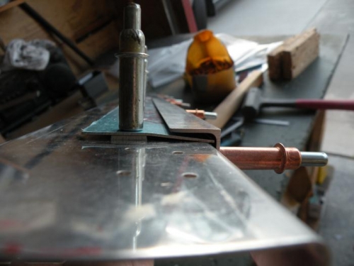

Today I finished drilling the seat back adjust parts.
I started by match drilling the end holes in both F-705K plates through the already-drilled shims. I then clecoed the plate and shim to the channel to finish match drilling. I had to unbend the plate slightly to get it and the shim to lay flat on the channel. I had over bent the plates slightly, thinking they'd spread when I clecoed them in place. Instead, the channel bowed in, leaving a gap between it and the shim. Photo 1 shows the proper fit.

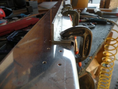

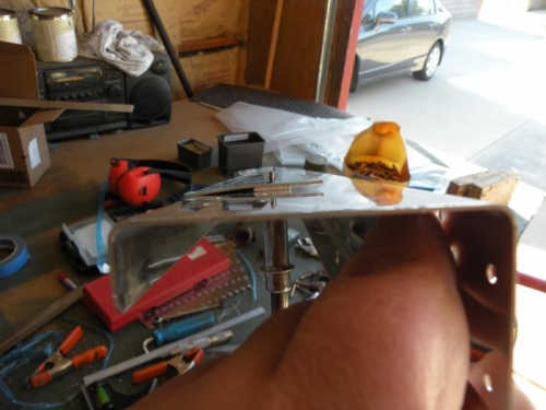

I set the spacing between the channel and angle by inserting a piece of 1/8" angle and clamping it in place before match drilling the channel through the angle (photo 2). Photo 3 shows the final fit of all the parts.
Proper fit between the channel, shim, and plate.
A piece of angle sets the spacing.
The final arrangement of the seat back adjustment parts.
