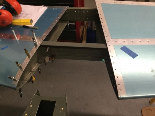

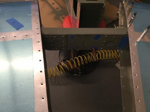

Horizontal Stabilizer Repair
Reclecoed the front spar channels and their reinforcements. Checked rear hinge alignment used a taut nylon thread; all OK. Began riveting front spar parts.
Rivets Today: 22
Rivets Total: 11750
