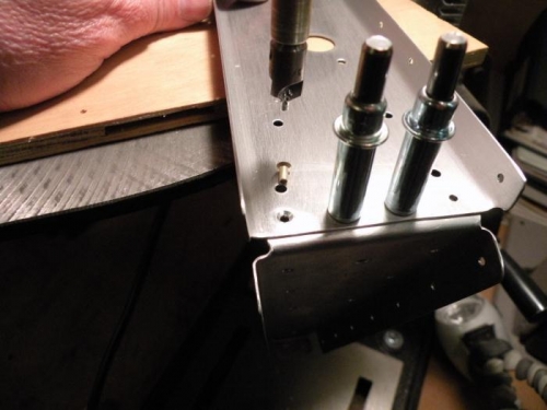

I countersunk both E-702 elevator spars where they attach to their respective root ribs. The countersink cage wouldn't fit close enough to the spar to get the top and bottom holes, so I set up my drill press with the counter sink in the speed handle extension. (See Photo 1). I had to go slow and after 4 or 5 iterations the rivets fit nice and flush.

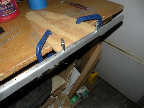

Next, I countersunk the top flange of the E-606PP trim spar. I was going to clamp it to the table edge and drill to the table for pilot holes, but the spar was just a bit too narrow. Instead, I clamped a piece of 1/4" plywood to the table and match drilled pilot holes in that. Came out great.

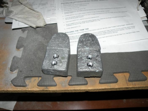

Next, I countersunk the E-714 counterweights to fit the #10 dimples in the E-713 counterweight skins. I tested the setup in some 0.125 scrap I had, and noticed that the dimple die and countersink make slightly different angles. Even when the countersink in the scrap part was at least 0.010 deeper than the dimple was tall, the surface around the dimple wouldn't lay flat in the countersink. I set the depth for a #10 screw plus about 0.030 and called it good.

Countersinking close to the E-702 Spar Flanges with the Drill Press.
My setup for countersinking the top flange of the E-606PP trim spar.
E-714 counterweights countersunk for #10 screw dimples.
