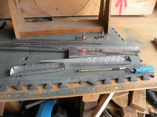

Trailing edge bender made by a local RV-7 builder/flyer/retired finish carpenter.

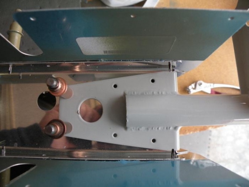

Very good fit on both elevator horns.
