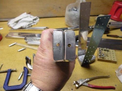

I squared the flanges, straightened by fluting, and edge finished both sets of E-703 end ribs and E-704 counterbalance ribs. Upon initially attempting to assemble these ribs to the skin, there was a misalignment of some of the rib holes. The cause is that the ribs are slightly bowed across the web, plus the pre-punched #30 holes used to rivet the ribs back-to-back were slightly dished from the punching process causing the flange radii to not quite come together, Checking VAF, I found that one builder had gotten rid of the bow by placing the rib on the bench flanges down and tapping gently on the web. I flattened the holes by putting 2 flat sets in my DRDT-2 dimpling tool and flattening them the best I could. The results are shown in Photo 1.

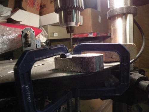

Next, the counterweight is pushed into place and marked for the two 3/16 bolt holes to be drilled in each one. I marked the weights by drilling just a slight depression using the front of the countebalance skin as a guide. I then lightly clamped the weight to my drill press table and drilled perpendicular pilot holes all the way through it.

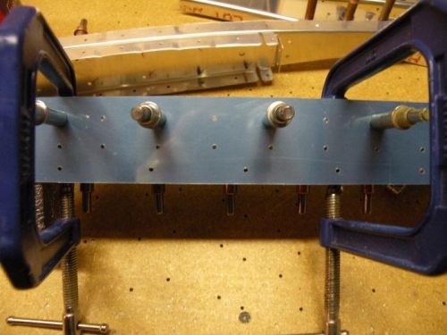

I then reassembled the ribs, skin, and weight, firmly clamped the two ribs together at the forward ends, and using my hand drill, drilled through the weights with #40, #30, 5/32, and 3/16 drills successively. Photo 3 shows the resulting bolt holes in the ribs' front flanges.

It took some massaging and clamping of the ribs to get the counterbalance skin holes to line up.
E-714 counterweight secured for initial drilling.
