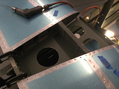

Brief Description:  Replacement of HS-714 Attach Angle
In addition to various aft fuselage parts, the mis-drilled HS-714 attach angle also needs to be replaced. This requires removal of the inboard main and nose ribs for access to the outboard rivets attaching the HS-714 to the front spar. I started the process by drilling out the HS skin to inboard main and nose rib rivets.
