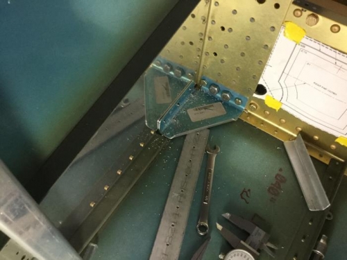

Brief Description:  Forward Fuselage Gussets
Clamped F-7114R securely in place and match drilled through side skin and lower longeron. For the drilling, I stepped through 3/32, #30, and 11/64 drill sizes followed by a 3/16 reamer.
Both gussets now need to be deburred, prepped, and primed before final installation. Even when I do install them, I will install the AN3 bolts through the lower longeron only loosely, and torque them only after final wing installation.
