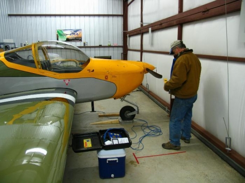

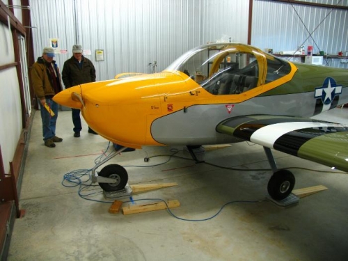

Bret Smith came over today to help with our Weight & Balance. Aircraft was leveled and weighed.

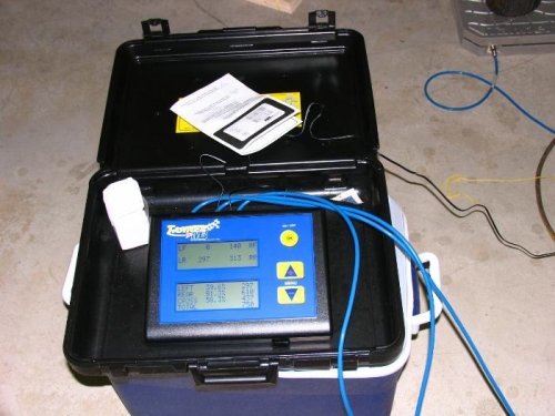

Final weight came in as follows:
Left main: 298 lbs, Nose wheel: 138 lbs, Right main: 314 lbs. for a Total: 750 lbs.
Empty ARM = 82.185 inches
Empty Moment = 61639.0 in-lbs.
Bret setting up aircraft scales
Total empty weight: 750 lbs.
Jack Ryan stopped by to help.
