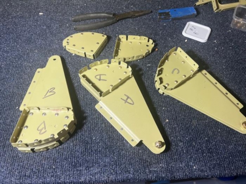

Brief Description:  Flap Hinge Brackets
It took me some time to read and understand the assembly procedures but it went smoothly after I looked at the schematics several times. The drawings are very helpful but sometimes I wish Vans made them a little bit more detailed and larger.
I labeled the end hinge bracket assemblies A and C. I labeled the center assembly B. This way I can reassemble the same way with all holes lining up properly.
Priming was done and then riveted with AN470AD4-4 to hold together, Now time to rivet to spar and then on to skins. The flap is much larger than aileron.
all brackets riveted for right flap
